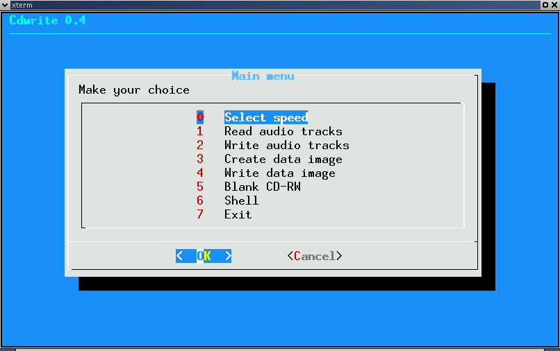

Dit heb ik ondertussen ook nog gevonden:
cdwrite:
Got X? No? But there's too much to remember to burn a CD on that VT-only server with the brand new high-performance CD burner? Miss your xcdroast, gcombust, k3b, whatever? Try cdwrite. It takes the pain out of creating a data image and writing it or reading and writing audio tracks. If you have the tools installed, you don't have to keep re-reading the man pages simply to burn an image. Requires: bash, cdparanoia, cdrdao, mkisofs, cdrecord.
Zou ook al mooi zijn. (als het al zou werken tenminste :(( )
